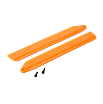

                    Here are pics of the two optional canopies and mainblades made by blade:
                    The blue one looks quite nice - considering it's designed by blade and "TheStyleExpert" Raymon Robinson.
                    The lack of visibility might be a problem.
                    But these blades
                    might do the trick.
                    It's shame that there are no white blades available yet, they would match the colours of the blue canopy perfectly.
