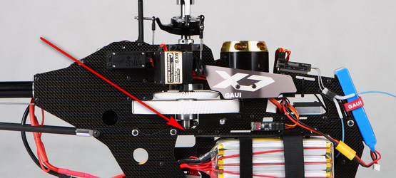

          Wie hast Du denn die Welle fixiert ? Ein kleinen Stellring genommen ?
          Gruß Olli
          Sorry, but explains a lot easier in English for me:
          There is a downside to the collar: this way all the pitch loads (pos and neg) are taken by the middle bearing of the main shaft. You will eventually get up and down play in the main shaft.
          I took the collar out and filled the space between the bottom bearing and the oneway with shims (red arrow below). You have to make it a tight fill. Now neg pitch loads are taken by the bottom bearing and the two bearings are preloaded to prevent play.
          It works very well (over 200 flights and no play at all)
          (the picture is just taken from internet for showing where the shims are placed)

            Ah ok, thanks Dekker
            Gruß Olli
